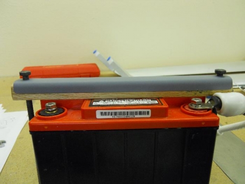

Brief Description:  Fabbed battery positive cable, mod to hold down cl
Cut the positive cable and crimped and soldered a lug to the cable, then added heat shrink. Test fit the cable and should work ok. I was concerned that if the battery hold down bar ever slipped, that it could short across the positive and negative posts of the battery since it fits quite close. I cut a piece of oak to fit inside the hold down channel to insulate the hold down from ever being able to short the battery. Rounded the inside edges of the oak to fit inside the channel. Battery tray is now ready to be permanently installed followed by the battery.
Oak added to inside of hold down channel
The oak will insulate the hold down from the batt posts
