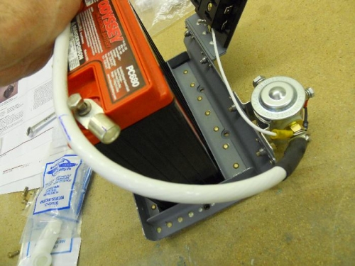

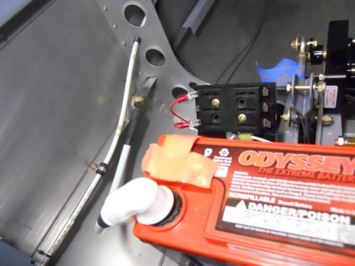

Brief Description:  Fabbed ground wire to battery
I cut the ground cable to an acceptable length (whatever that is), and crimped/soldered a lug to the open end—added some heat shrink. I installed the battery and tray once again then connected the ground cable to the mount on the longeron and the other end to the battery. Looks good to me. I removed the battery and tray. Next I crimped/soldered a lug to another piece of #2 cable—this cable is darn stiff to work with. I bolted the lug to the master contactor and measured where to cut the other end that connects to the positive side of the battery.
Ground cable from batt to longeron

Another shot of battery install
