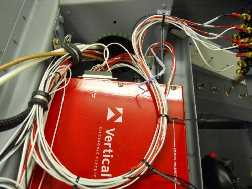

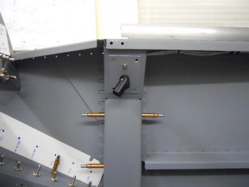

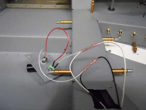

Finished up wiring the pilot’s map light. I daisy chained the front and rear map lights. Used a couple of butt-splice connections to tie-in the wiring for the front light. Finished up by running the wires to the panel area. Connected the ground wire to the forrest of tabs with a faston connector and the positive wire got a barrel crimped and inserted into the J1 dsub on VP-X. This pretty much finishes up most of the wiring of the fuselage except for the connections between the Garmin 430, audio panel and the Dynon 1000. Just as I think it is mostly done, I’ll probably find a few more wire related items. For now, I’m moving back to the dreaded pink canopy skirts.
