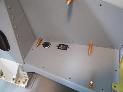

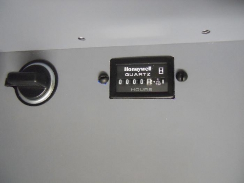

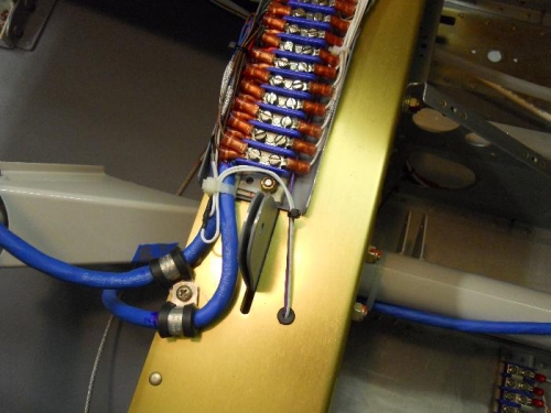

Tonight was more work on the F881 console plate—this time to add a Hobbs meter. I laid out a template on some scrap and then used the scrap to transfer the pattern to the console plate. I opened the center with a unibit, then used a nibbler to get close to the edges. Finished by filing to the final trim line. After I got the meter to fit, I match drilled the mounting holes using the meter as a guide. Will run some wires and call it good. I also ran a couple of wires to the terminal block where the front & rear stick wiring connections are made. I connected a wire to the rear stick ground wire. This wire will be connected to a small toggle switch. With this switch I can lock out the functions of the rear stick without having to disconnect the plug that connects the grip wires to the terminal block.
Console plate with power plug and Hobbs meter
Hobbs meter needs to get some time on it
Tied in a wire to open the ground on rear stick
