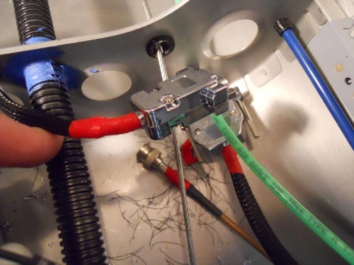

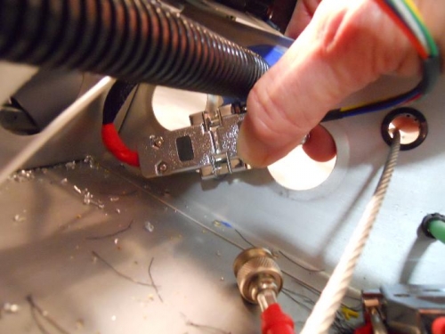

Received a new 9 pin dsub, so back in the tunnel to insert the pins. I added some heat shrink tubing and wrapped the wire and snake skin with some self fusing tape. Installed the dsub shells on both the dsub connectors. Decided against zip tying the connector to the conduit—didn’t seem solid enough. I will attach the connectors to the bulkhead with a zip tie—maybe two. Once the connection is secured, I can mount the servo and begin with safety wiring the bolts. I’ve just about enjoyed all the working in the tunnel that I can stand for a while.
Added shell to cable that runs to front
Possible location to secure connection

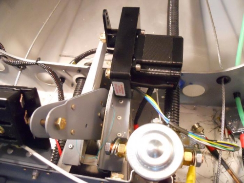

Rather congested back here.  Note green floss keeping washers in place on bell crank.
