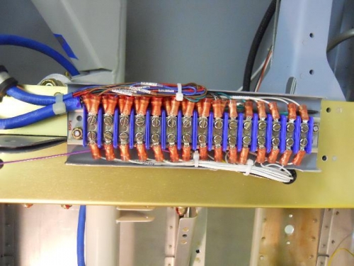

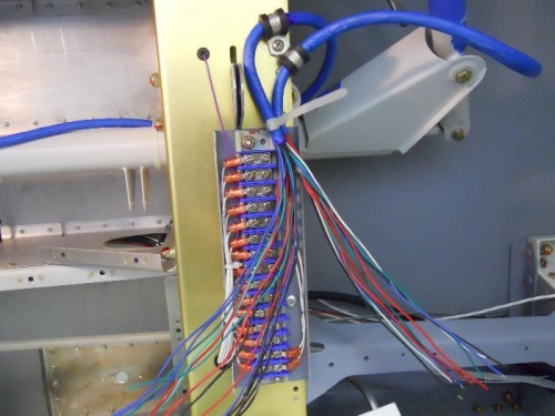

Brief Description:  Terminal Strip Wiring-4
Today I finished connecting all the wires from the front and rear stick grips to the terminal strip—all 26 of them. For each wire, I cut a label, inserted into clear shrink tubing and slipped it over the wire. Next I trimmed the wire to length, stripped the end and crimped on a ring terminal. Then I shrunk the clear tubing and screwed the connection to the terminal block. I added a small tie wrap to keep everything in place. Looks good-thanks again to Mike Elliott for pics and log of how he accomplished this wiring task.
Hope all those wires will fit--

Stick grip wiring DONE!
