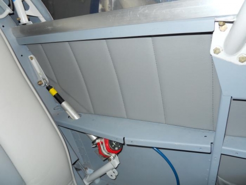

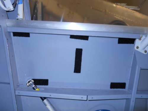

I got most of the panels installed today—just a couple to finish up. The panels are held in with Velcro. I added an extra piece or two on several of the larger panels to help them conform to the curvature of the side skins. I used the panels to cut paper templates so I could tell where to stick the Velcro to the skins. All the panels seem to fit quite well—Abby at Flightline Interiors did very nice job.
Velcro to hold panel
Panel installed
Panel installed
