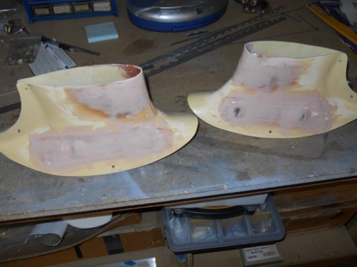

I got my voltage issue worked out—it was a switch setting in the VP-X that was not turned on. After I made the change in the setup, voltage displays correctly. I removed the intersection fairings and ripped off the peel ply. I sanded the fairings, then mixed up some micro and spread over the areas which were previously glassed. Back to the sand and fill routine!
Sand, then added micro
