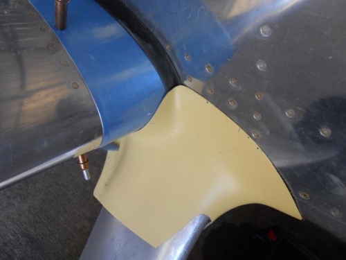

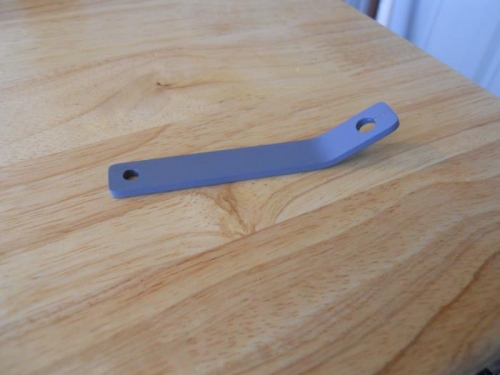

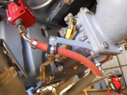

I checked the fit of my bracket to stabilize the red cube, then removed it, cleaned it up and shot it with primer. After the primer dried, I installed the bracket, bolted it to the fuel servo and added an adel clamp to hold the line to the cube. Seems solid enough-calling it done. I used a heat gun on the right intersection fairing and was able to contour most of it to the fuselage and wing. There is still a few small gaps which I will take care of with micro. I drilled a couple of holes in the aft flange portion of the fairing—I’ll use some screws to clamp together. I also drilled a hole in the inboard flange about in the center between the gear bolts. I removed the gear cover and taped in a piece of wood—re-installed the cover and used the hole in the fairing to drill thru the gear cover. I think may be the only attach point on the fuse that is needed—we’ll see. I moved to the left side and worked the fairing with heat—got a decent fit. I’ll tweak both sides tomorrow with more heat and get holes drilled for the left fairing. And then—I’ll mix some resin and have some fiberglass fun!
Bracket for cube
Bracket for cube
Bracket installed
Bracket installed
L. intersection fairing-now fits ok
