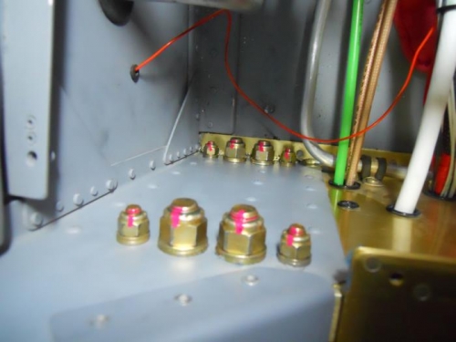

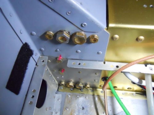

Today was “torque wing bolts” day. I started with the large bolts (500 in./lbs) torquing one upper then one lower, then one upper and the final lower. Did this for both sides. Took a short break and torqued the smaller bolts (70 in./lbs) alternating between upper and lower as I moved along. I applied some torque seal to all bolts. So, all 20 wing bolts are in and torqued. Feels good (except for my back) to be done with wing bolts.
Left side nuts
Left side nuts
Left side bolt heads
