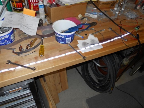

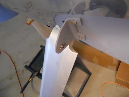

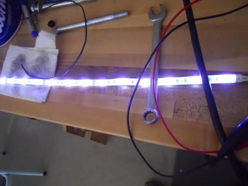

I got a bunch of the labels printed and applied today. I still have to make a diagram of the buttons on the Infinity stick and print a placard for them. I also worked on some miscellaneous items. I bolted the MK1000-428 nutplates to the F-863-1 tank attach brackets, then used the nutplates as a guide to drill for some AN426AD3-5 rivets. I machine countersunk the holes and used the pneumatic squeezer to set the rivets. Next, I removed the dimmer switch I had on the console and rerouted the wires. I am going to add 2 dimmers to the right instrument subpanel. I received an LED strip of white lights that I plan to glue under the glare shied for indirect lighting. One of the dimmers will control the glare shield LEDs and the other dimmer is for the GMA240 audio panel. I began running wiring for the LED’s but ran short of time.
Tank attach nutplates
LED strip-on low
LED strip-on low
LED strip-on high
LED strip-on high
