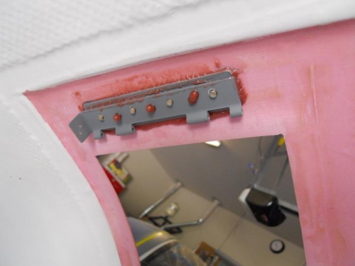

Brief Description:  Glass around pin covers, rivet oil door hinge

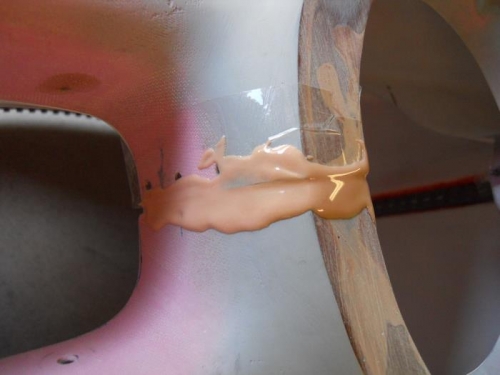

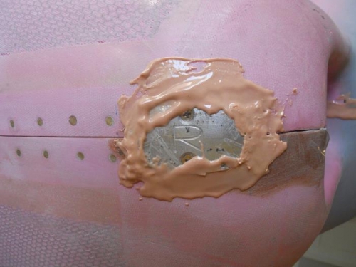

I added some packing tape around part of the nose bowl opening as well as the hinge pin covers. I mixed up a batch of resin and poured a small quantity into another cup to which I added some flox. I used this resin/flox mixture to spread on the cowl where the oil door hinge is about to be riveted on. I clecoed on the hinge and squeezed the rivets. I then added some micro to the original resin and applied around the nose bowl and the hinge pin covers. The mixture was getting rather warm and very thick as I started on the last pin cover, so it may take some sanding and another coat. The covers stick up just a wee bit, so I’m trying to build up around them to make them fit perfectly flush.
Oil door hinge riveted to cowl
Filling joint around nose bowl
Build up some micro around pin cover
