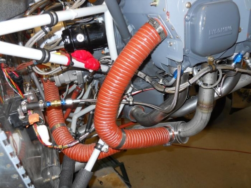

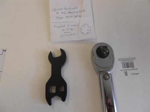

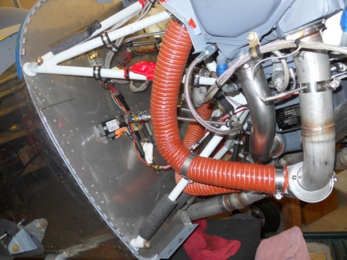

I installed an 18” length of scat tubing that runs from the back of the baffles into the heat exchanger around the right rear (#3) exhaust pipe. I fabbed a piece of stainless steel strap to wrap around the tube—this strap gets attached to an adel clamp mounted on the lower motor mount. I also torqued the prop bolts using the prop wrench which I received from AntisplatAero—very nice tool. I torqued the bolts to 45 foot pounds and then to 65 foot pounds. I followed Lycomings recommended tightening sequence. I was all set to safety wire the bolts, but .032 safety wire is all I have left. The prop bolts require .041 wire—seems there is always one more thing to order! I spent the rest of my shop time spreading hi-temp RTV on all of the baffle-to-engine gaps I had partially filled in an earlier session. Didn’t get a pic—to busy trying to get the RTV off of where it wasn’t supposed to go and into the crevices where it needed to go—what a mess. I used a 3” tube on the end of the RTV tube to help get in the really narrow places—hope it’s sealed good enough, cause I’m done with it!
Scat tube installed
Scat tube installed
Prop wrench used to torque 6 bolts
