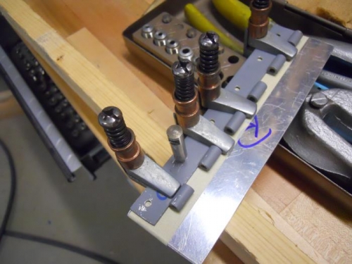

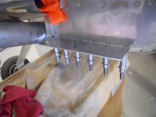

Happy Independence Day! I didn’t have much time in the shop today, but did get a few things done. First, I re-routed the wires for the Dynon GPS—didn’t like the location where they had to make the jump to the GPS mount. So, I followed some other wiring along the engine mount tubes to end up near the front of the mounting plate. Earlier, I had drilled out rivets to remove the hinge pieces that were to attach the lower cowl to the firewall/bottom skin. I made up some new mounting plates from some .063 plate. Rather than clamp and drill up through the holes in the fuse, I took a different approach. The rivet holes in the hinge piece were slightly larger than .040 from the rivets expanding in the holes. I drilled the holes in the hinge up to .125, then clamped the hinge piece to the new mounting plate. I used a 1/8” transfer punch thru the holes in the hinge to punch a divet in the mounting plate. After all holes were marked, I drilled the locations in the mounting plate to 1/16”, and then to #41. I machine countersunk the back side of plate. Clecoed the plate into position—holes lined up perfectly with holes in the fuse. Repeat the same steps for the opposite side.
Usied transfer punch to locate holes in plate
Plate clecoed to fuse
