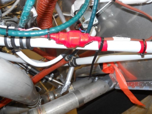

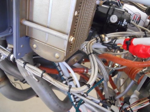

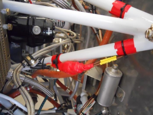

I fiddled around with wire runs for the left side CHT & EGT wires. The right side seemed to be more obvious as to location, but not so on the left side. Finally came up with a plan and got going. I ran the CHT wires low and the EGT wires high. I zip tied and added adel clamps where necessary until everything appears to be secure. I stripped back the insulation on the EMS leads and added the spade terminals. Plugged the connectors together and covered with shrink tubing, then wrapped the bundle in self fusing silicone tape. Went back and added some additional tie wraps. I still need to run the upper plug wires—at least I’m beginning to see an end to the f/w forward stuff.
EGT wires connected
EGT wires connected
CHT wires connected
CHT wires connected
EGT wire routing
EGT wire routing
