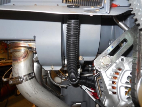

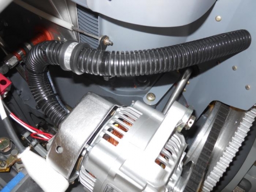

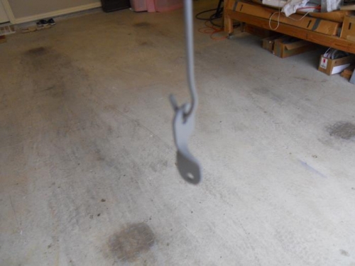

Log 2 of 3. I cut a 11/16” hole in the right forward air ramp using a step bit. This is for a blast tube to cool the back of the alternator. I fabbed a bracket from steel—heated with my torch to put a twist in it and drilled holes for mounting. Gave it a shot of primer,then a shot of black paint. This bracket will attach to the baffle tension rod and to an adel clamp which will secure the blast tube. I am using some of Van’s corrugated tubing (same stuff used for mag blast tubes) for alternator blast tube. I used a piece of heavy electrical wire zip tied to the tube to keep the curve needed to reverse the flow to the back of the alternator.
Fuzzy pic of bracket
Cool air blast tube for alt.
Another pic of blast tube
