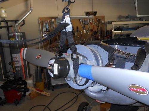

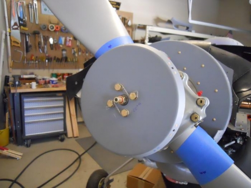

Brief Description:  Install prop, safety wire front backing plate
Got a fresh start on the prop install—went on just like it was supposed to—not sure what yesterdays problem was, but it is done. I also installed the front backing plate, torqued the bolts to 60 ”lbs, then safety wired them. I re-installed the alternator belt and set the tension at 12 ‘lbs. Then, safety wired the tension arm bolt. I also sanded the inside of the top cowling—hopefully for the last time—now ready for some filler primer. Then I started on the alternate air door and plug wire routing.
Prop going back on
Prop going back on
Torqued and safety wiered
