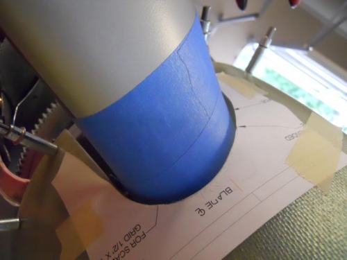

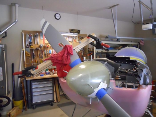

Sanding and filling etc continues on the ramps in the upper cowl. While resin/micro was curing, I turned my attention to the prop spinner. I cut some 1”x2” scrap, clamped them together and padded with a red rag to make a “constant speed prop twisting device (csptd for short)”. I had previously fitted the spinner, but needed to check clearance when the prop changed pitch. I taped some templates to the spinner around the cutouts,then twisted the blades using the “csptd”. Gotta tell ya, the spring in the prop dome is STOUT! I twisted and Nancy marked where additional clearance was needed for each blade. I removed the spinner and sanded for additional clearance. Re-installed the spinner, repeat the process again. After the third time, I ended up with a uniform clearance thru the entire range of motion. Now, I’ll move forward with finishing the cutout gap plates—probably will require another twisting to ensure they have enough clearance as well.
Ready to twist blades
Template for marking gap
