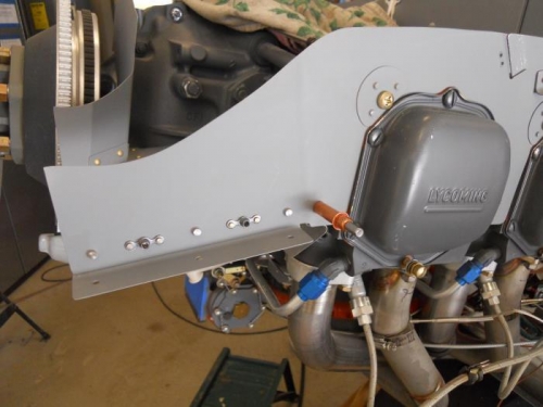

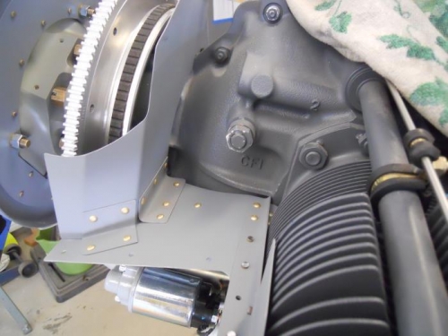

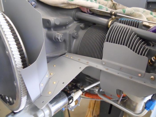

Brief Description:  #2 baffle assembly-final riveting
I finished up the #2 baffle assembly today. Added 11 nutplate –all attached with NAS rivets. I was able to squeeze all of the rivets except for 2—had to get the gun for them. Only had to drill out one rivet—the very first one I squeezed. Somehow the rivet set jumped off the edge and cracked the rivet. All the other set without issue. There is supposed to be a rivet that ties the side baffle to an angle riveted to the #2 baffle assembly, but I plan to put a #8 screw there—it will allow the side baffle to be removed separately from the rest of the assembly. I still have some work to do on the snorkel before I can call this done—then I’ll tackle the the air seal material.
#2 Baffle assembly-done
Another shot
Another shot
Cleco is where I'll use a #8 screw
