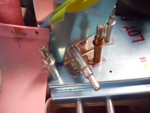

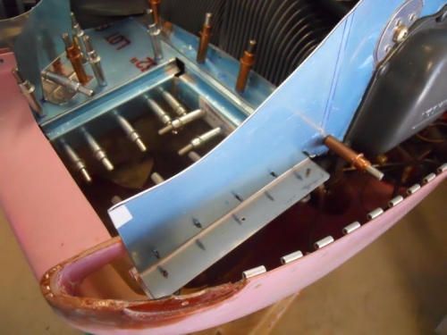

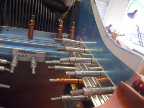

I bent some .032 to attach the forward left baffle to the left air ramp, punched some holes, then match drilled in place. Next, I fabbed a piece of .032 angle to attach the #2 side baffle to the air filter bracket. I punched some 3/32” holes, clamped in place and match drilled the assembly. Then, I drilled everything up to 1/8”, removed all the parts and started on nutplate mounts. I drilled up the attach points to #19, and used a jig to drill the holes to attach nutplates. Then I lightly countersunk for NAS flush rivets. I still need to make up some hold down plates to keep the air filter in place, but it’s getting there.
Clip to attach fwd baffle to l. crankcase baffle
Side baffle attachment to filter mount
Inside pic of side baffle/filter bracket
