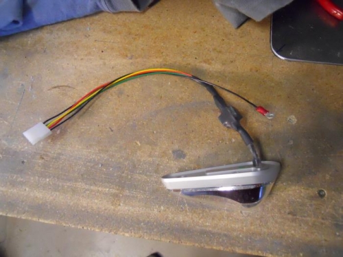

Brief Description:  Added wires to Molex connectors
Part 1--While waiting for the temp to warm up enough to mix some resin, I decided to get the Aeroled wiring taken care of. The Aeroled’s are supplied with some Molex connectors and pins. I started on the R. tip, installed the Aeroled light and fiddled with how I wanted to run the wires. I decided to add a nylon thingy so that I could zip tie the wire bundle. I crimped the pins onto the wires and installed in the Molex connector. I added an additional ground wire which will ground the light body to the end rib. Then I did the same for the L. tip except the wire routing goes thru some nylon clips on the Archer NAV antenna. Crimped on the pins, added an additional ground.
Installed wires into Molex connector
Wire routing-L. tip
