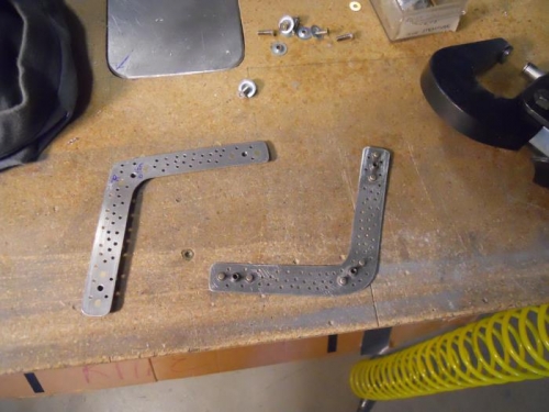

Today was a repeat of previous session-except this time was the right tip. I cut out 2 backing strips from .025 scrap, marked and punched holes. Drilled holes up to #28, used nut plate jig to drill holes, c/s holes with deburr tool for NAS1097 rivets. Squeezed in 12 rivets, scuffed up back with #60 grit. Drilled a bunch of 1/16” holes to help bond the strip to the inside of the tip. C/S holes in plexi, screwed everything together to check fit.—Done! It wasn’t warm enough to mix resin today, but tomorrow should be ok.
Nutplates riveted to backing strips

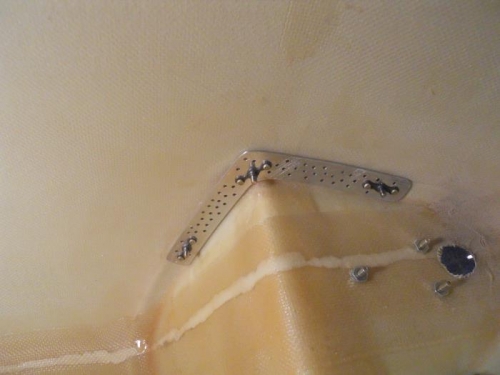

Test fit of backing strip

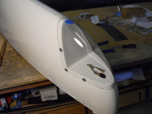

Checked fit of lens--good
