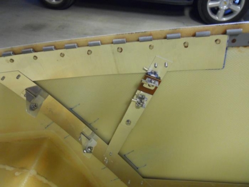

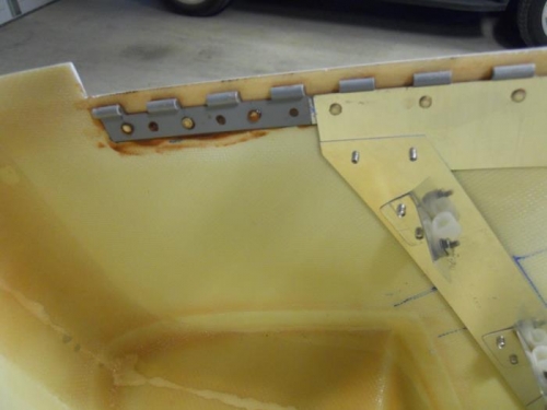

Happy New Year! I mixed up some resin with flox and applied to the inside of the left tip, lower surface. I clecoed the hinge piece in place and began riveting. I also added the Archer NAV antenna which was riveted in as well. This will tie the ground plane of the antenna to the entire airplane. Did the same dance—clean out all resin between the eyelets and off of the face of them as well. After this cures, I will add several strips of glass across some areas of the antenna to keep anything from flopping around.

Forward end to tip
Forward end to tip
Antenna riveted along with hinge
