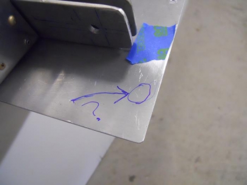

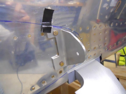

I spent much of the day re-arranging and re-positioning the shop. After that task was completed, I finished up the tank attach brackets. When I fit them to the fuse with the wings on, I had drilled pilot holes to #30. I used locking clecoes to clamp down the upper hole, while drilling the lower hole to #13, followed by a reamer. After the lower hole was drilled, I inserted the bolt and cranked it down really tight. Then drilled out the top hole. Repeat for the other side. I removed and deburred all the holes. Then I drilled a 1/16” hole in the bracket to be used as an anchor for the safety wire. Next, I deburred all the holes previously drilled for the wing root & flap fairings—both on the wings and the fuse. I discovered I had missed a hole on the lower aft skin—yikes! I’ll make up a transfer strip to screw to the wing skin and match drill –then I’ll screw the strip to the lower fuse skin and match drill.
Tank attach bracket drilled to fuse
Missed drilling a hole!
