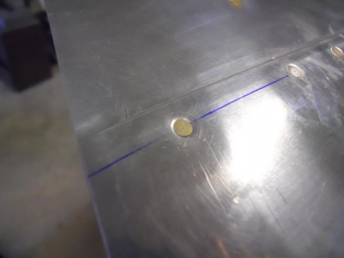

Added rivet to join overlapping flap skins

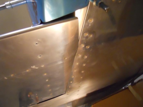

Gap between flap and fairing

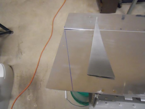

Trim line for R. flap-other scrap was removed on L. side
