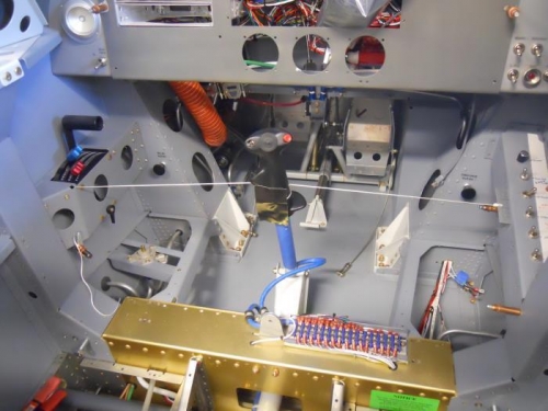

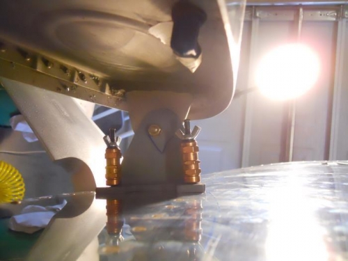

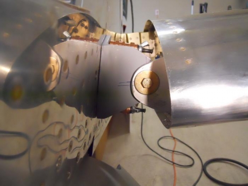

I used some draw clecos to firmly attach the left tank bracket to the fuse. Did some measurements for a hole location to match drill thru the T-405 tank angle and the F-863-1 tank attach bracket—minimum edge distance is ½”. I used about .65”. Center punched the T-405 and used a #40 to start the hole. Then I used a long 1/8” drill and a drill guide to drill the holes. I opened them up with a letter “C” drill. I inserted the shank of a ¼” ream, chucked it in the drill and pulled the ream thru. I am beginning to like this method whenever I have adequate space, cause the reamer only make one pass thru the hole. I added a bolt and washer—when the wing is removed, I’ll slot the T-405 tank tab and add a nutplate to the attach bracket. Next up was to center the control stick in the cockpit and adjust the W-816 aileron pushrods. I hadn’t seen them for over a year and found them in bubble wrap inside the wing—however, they were in the wrong rib holes, so I had to remove and reinsert them. In my garage I only had about 3” extra width to get them out—dodged a bullet on that one! Anyhow, I used a string wrapped around the control stick and secured on each end—put a level on the stick and got it where I think neutral is. Hooked up the W-816 pushrod to the WD-807 control column. Next up is to use the aileron jig to set the aileron bellcranks to neutral, then get the ailerons installed.
Drilled and bolted tank attach bracket
Aft side of attach bracket
Control stick in neutral position
