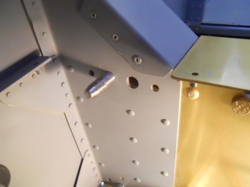

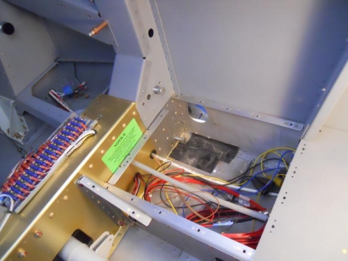

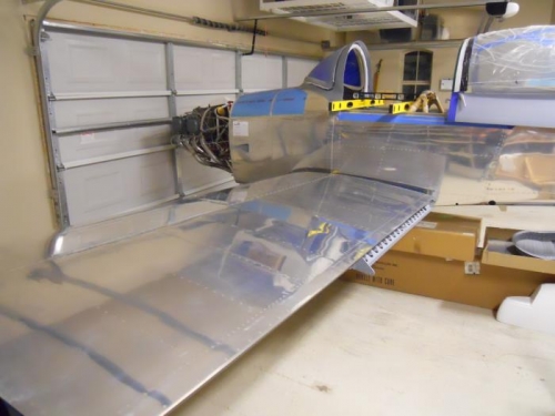

More wing install pics. In the middle of the night (when I get to thinking) I started thinking that the lower right pin was very hard to get started. I imagined the pin hitting the spar as I gave it a few polite "smacks" with a rubber hammer. Then I began thinking "what if I dinged the spar". Well, that kept me up most of the night. This afternoon, I grabbed a couple of neighbors and pulled the right wing. I inspected around the hole and not a mark. Whew! Dodged a bullet on that one. Didn't take but 10 minutes to pull, inspect and re-install. My advise to anyone following this blog is to taper the pins for at least an inch or more in order to more easily get it started.
Nose very close to door!
