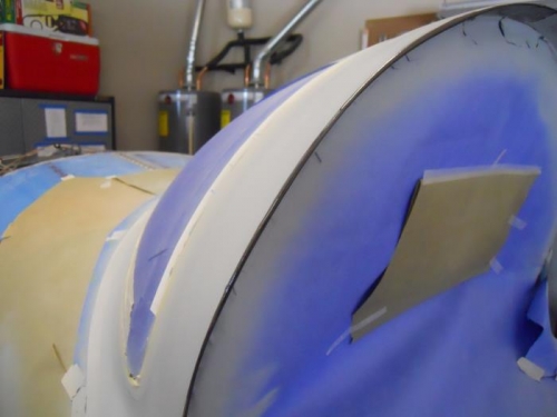

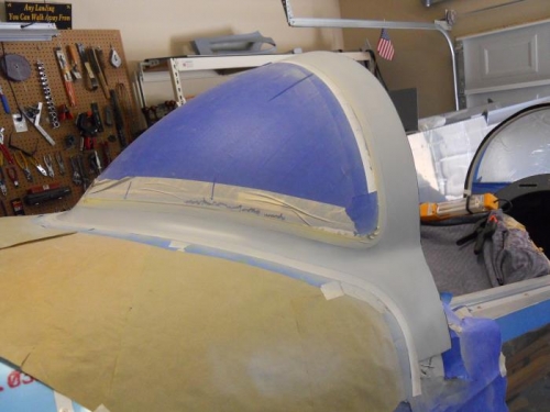

Brief Description:  Windscreen fairing-21
I re-taped everything, mixed up some micro and added to my trouble spot. After it dried, I lightly sanded, then shot a coat of sanding primer. After the primer dried, I lightly sanded with a very fine foam block. Looks and feels pretty good—probably should stop here and call it done, but no—I want to dress up the aft edge of the fairing just a bit. I block sanded, then added some micro to the edge.
Sanding primer looks ok
Touched up the aft edge of the fairing with micro
