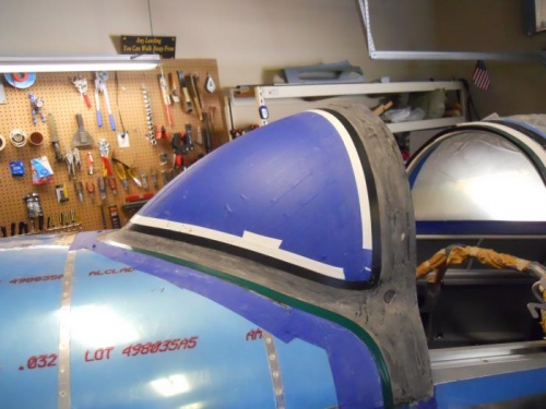

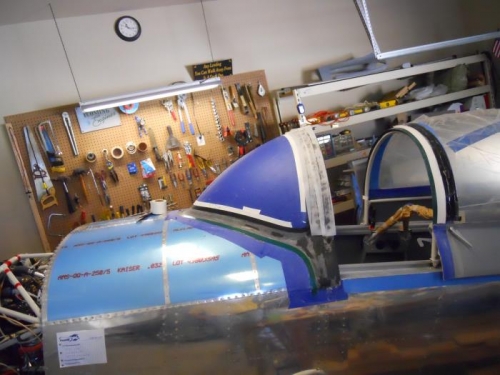

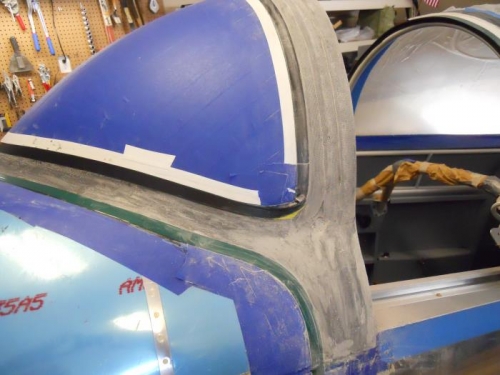

Brief Description:  Windscreen fairing-11
Yesterday, I added some flox across the canopy bow, but the glass still seems too thin. I sanded it down (AGAIN), re-taped everything and added another layer of glass. Later today, after it had dried, I lightly sanded it to smooth the edges. Tomorrow, I will add add another coat of resin with flox.
Sanded flox and taped again
Added another layer of glass & peel ply
Later--removed peel ply and lightly sanded
