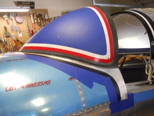

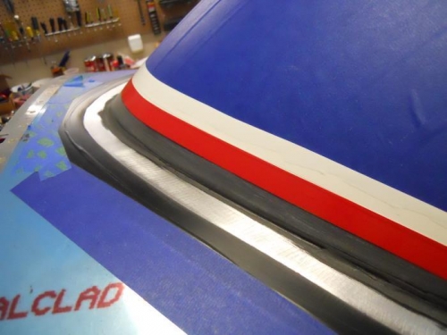

Brief Description:  Prep for Windscreen fairing
I ran another line of tape over the yellow tape—used red instead of black. Then I ran a line of black tape around the skin approx ¾” out from the edge of the plexi. This line will mark the forward edge of the fairing. Continued the black tape at the aft end and ran it down the side where I’ll lay up glass to ride over the canopy skirt when the canopy is shut. I heavily sanded all of the exposed skin and plexi with 80 grit to give a good bonding surface. My plan is to fill the joint with a very dry micro mix, then begin laying up the glass strips.
