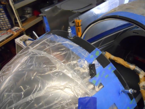

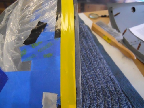

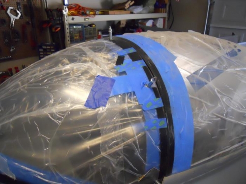

I put the windscreen on the fuse, but it wanted to wiggle around so, I got it placed where I think I want it to reside and drilled a hole in the top aft end. I used a 1/16” bit, then opened the hole up to #40. Drilled thru this hole to mark the location on the roll bar. I removed the windscreen and finished up the hole in the roll bar. I put the windscreen back in position then clecoed. This worked ok, so I marked and drilled 4 more holes. I used some spacers made from 1/8” vinyl tubing. With the windscreen fixed in place, the canopy won’t close completely—several areas along the aft part of the windscreen weren’t very even from the big cut. I marked them, removed the windscreen, used the bandsander to remove the excess, then filed smooth and re-installed. I probably did this at least a dozen times. Now the windscreen pretty much is even with the front of the canopy. I removed the windscreen and closed the canopy completely, then placed the windscreen back into position. Looking thru the aft top part of the windscreen I could see the hole in the roll bar. I measured this distance-.1”, then added 1/16” to that number. Used a popsicle stick with a hole in it to draw a line around the aft part of the windscreen. Next session, I hope to get this excess removed and prepare to glue the windscreen on.
Windscreen clecoed to roll bar
Fitting windscreen against canopy
Plexi to edge of tape needs to be cut-about .17
Plexi to edge of tape needs to be cut-about .17"
