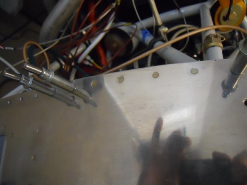

Brief Description:  Remove top skin, squeeze iin a few rivets
I removed the 4 temporary pop rivets holding the fuse side to the f/w. I pulled back the skin (as best I could) and filled in between with firebarrier 2000. Clamped & clecoed the skin back to the f/w and squeezed in 4 rivets on each side. Was fun mashing rivets! The rest of the holes on the sides have to wait for the side hinges for the lower cowling. I removed the top skin—ready to dimple holes on the forward part of the skin, firewall and c/s the upper hinge piece. As a side note, only one very tiny bubble appeared overnight in the left brake line.
4 rivets-left side
4 rivets-left side
