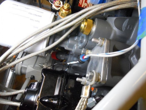

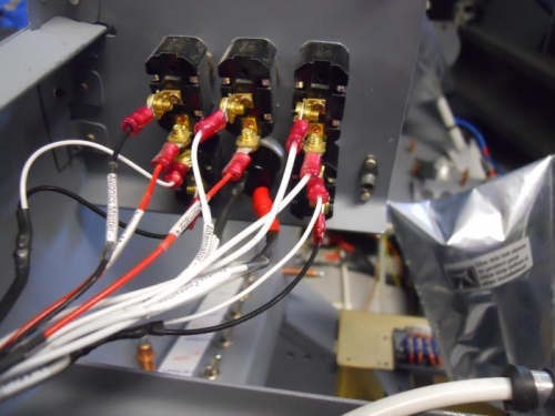

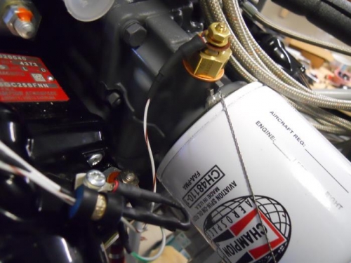

I soldered a resistor in-line for the RPM pickoff on the right mag. Then, connected the terminal to the right mag and secured it and the p-lead with an adel clamp. Next I secured all wires to the mags and temperature sensor to some of the engine mount tubes. Cleaned up the excess wire and bundled the wires with tie wraps. I changed out a couple of adel clamps to better secure some of the wire bundles. I terminated the ends of the p-leads and connected them to the toggle switches in the cockpit.
R mag wires secured with adel clamp
Temp sensor & L mag wires
Mag wires terminated to toggle switches
