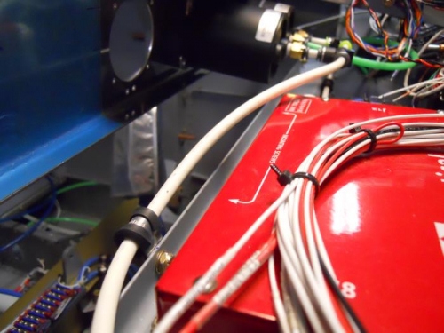

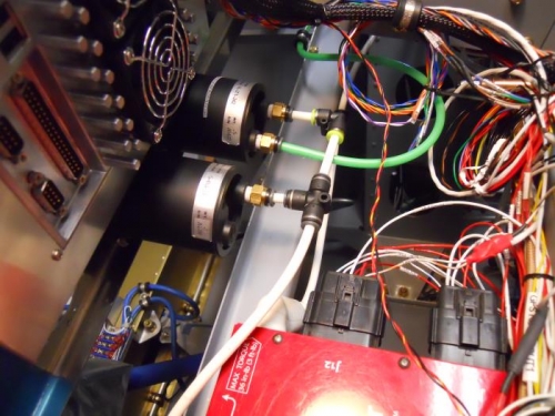

I left the EMS module in place and decided to work on plumbing. I installed the a/s and alt into the panel, then clecoed the panel to the fuse. I marked the crossmember between the gear towers for locations of a couple of adel clamps. Removed the panel, drilled holes, added a couple of adel clamps to secure the pneumatic lines. I cut some small lengths of tubing to connect the a/s and alt to the static line. I don’t like the bend in the pitot tubing line, so I plan to order a couple of 90 degree fittings and straighten out that line.
Clamp static line
Clamp static line
Plumbing for A/S and Alt.
