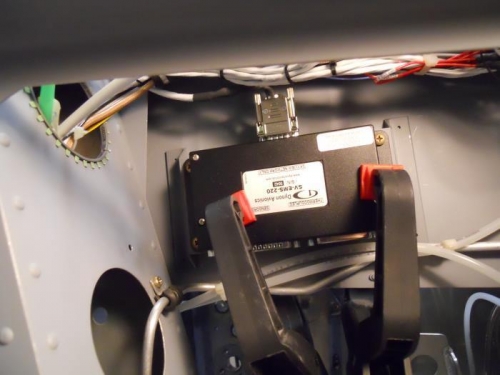

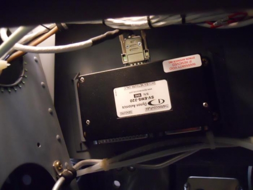

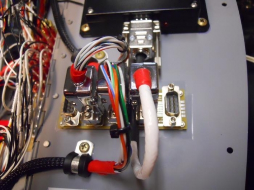

I positioned the EMS module on the left side of the F886A1 bulkhead. I mounted it as high as possible so that the Skyview network plug almost touches an existing adel clamp. The network cable will have to be attached before attaching the module to the bulkhead. The mount is at a slight angle so that the right wire connection on the bottom of the module is above the lower portion of the bulkhead as much as possible. I clamped the module to the bulkhead and match drilled the #40 pilot holes in the brackets to the bulkhead and clecoed into place. I ran the network cable up to the distribution hub. I think I’ll leave this as is until I get the wiring harness that connects to various senders, etc on the engine. At this point, I want to make sure the connections on the harness don’t hang too far below the bulkhead. If they do, I’ll have to relocate the module somewhere else—probably in the baggage compartment, which I’d rather not do. I also re-did the cable from the ARINC module to the hub. The original was just too short--this will work better.
EMS module clamped to bulkhead

Match drilled and clecoed
Redo of ARINC cable to hub
