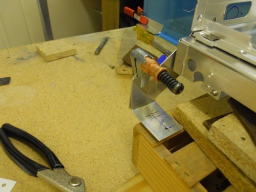

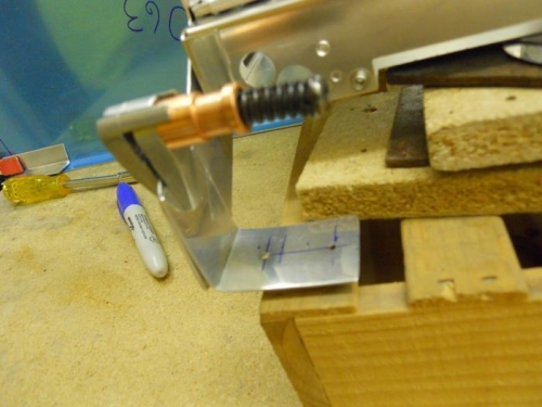

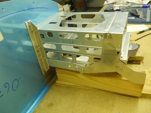

I previously had installed the panel and radio trays into the fuselage. Used some poster board to approximate the bracket I needed to stabilize the aft end of the radio trays. Removed the panel and the right rear bracket. I used the bracket and the poster board to lay out a new right bracket with a “leg” to tie the crossmember. Cut out the new bracket with a hacksaw—a bandsaw would have gone much faster, but I don’t have one. I also bent a piece of .032 that will connect the bracket “leg” to the crossmember. Reinstalled the right rear bracket. Next session I will match drill the .032 tab to the crossmember and the bracket “leg”.
New right rear bracket
Tab to tie bracket to crossmember
Another pic of tab
Another pic of tab
