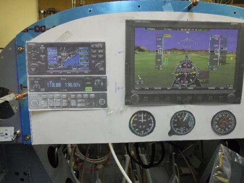

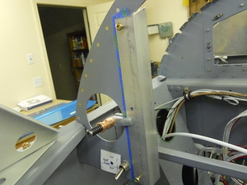

I received some 1x1x1/16 angle from ACS today. I cut a piece of angle and match drilled to the left side of the panel. This will be the left mount for the radio stack. I sandwiched the angle between the instrument panel and the sub panel. This allows the radio stack to move about 5/8ā€ to the left which will help better center the Dynon screen. Although the panel on the left is raised above the sub panel by 1/16ā€ because of the angle between the panels, it will never be seen once the top forward skin is attached. Thanks go out to Widget for the tip. Iā€™m still waiting on the avionics from Stein before I can cut the panel.
Left radio stack angle match drilled to panel
Angle trial fit to sub panel
Panel fit to fuse with left radio stack angle in place
