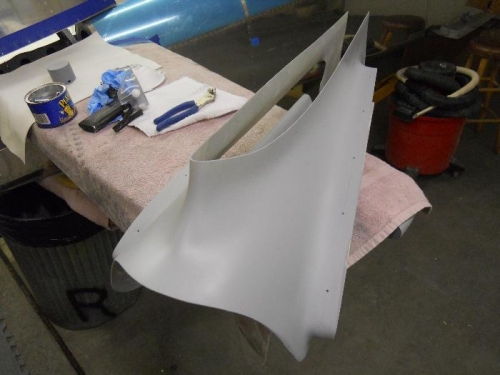

Brief Description:  Empennage Fairing-18

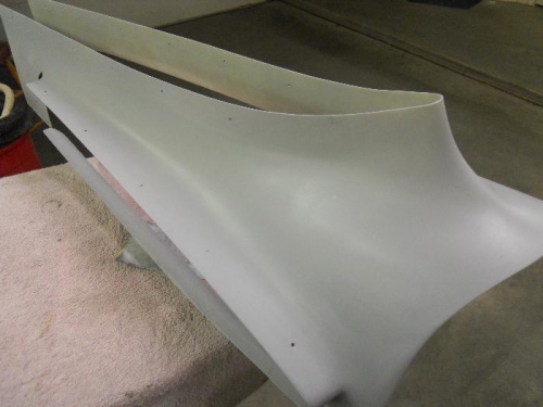

Sanded the micro which I had added over the new glass. Then I sanded the entire fairing and shot it with a coat of sanding primer. I had pretty much taken care of the pin holes in the micro I had added, but the rest of the fairing has a good amount of them as well. I will have to sand the areas and fill the holes with resin.
Pin hole dance is next!
Can't see the pin holes in the pic, but they are present
