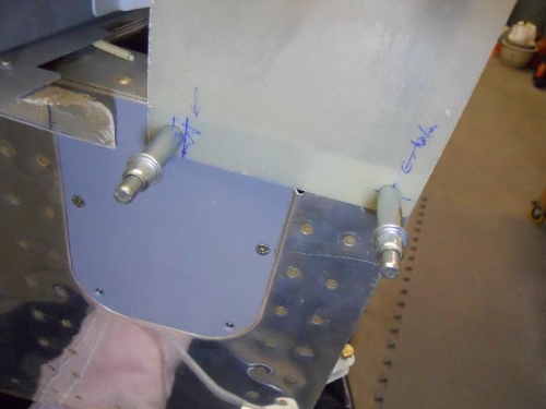

Brief Description:  Empennage Attach-10
Marked and drilled the lower two mounting holes for the fairing on the left side. Removed the fairing and traced the elevator tube cut out on the right side, then copied it onto the fairing on the left side. Trimmed the fairing for clearance of the elevator tube. Tomorrow I’ll install the left elevator just to make sure I have some clearance around the tube of the elevator horn.
Drilled mounting holes-left side
