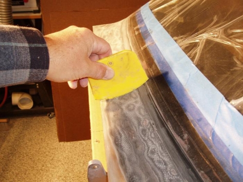

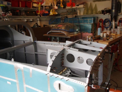

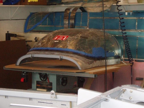

I decided to take the canopy off and put it on the bench to finish smoothing the fairing. I can reach it better and I can work on other things.
Directions in the plan say to lay down a layer of epoxy resin to smooth the fillet. So I did, but I made a scraper with the proper curve so I can smooth the layer of resin I lay down so it is not too thick.
Took canopy off to finish
I'll finish the canopy here
Scraper to smooth resin
