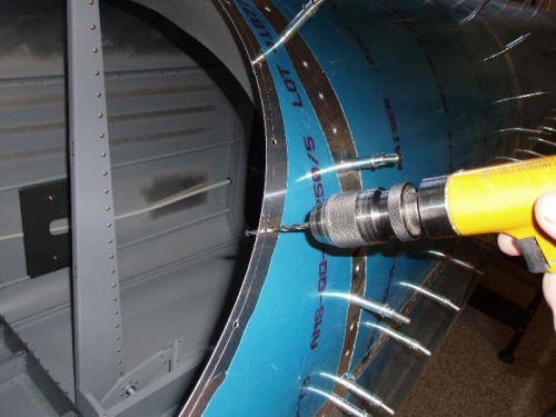

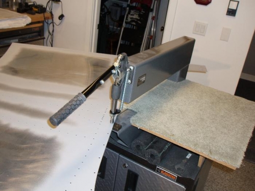

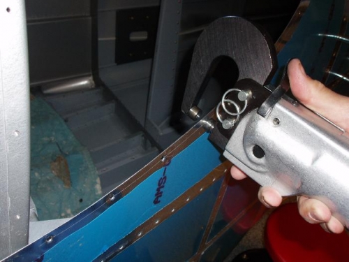

The top aft skin holes need to be enlarged to #27 for a #6 screw and dimpled. So I drilled and deburred the holes. Then I first tried my pnuematic squeezer to dimple but I thought I was getting a slight deformation. So I took the skin off and dimpled and the bench. Looks the same. No difference. Big #6 dimples just look a little wavy.
Enlarged skin holes to #27
Dimpled for #6.
Dimpled for #6.
Dimpled #6 (no difference)
