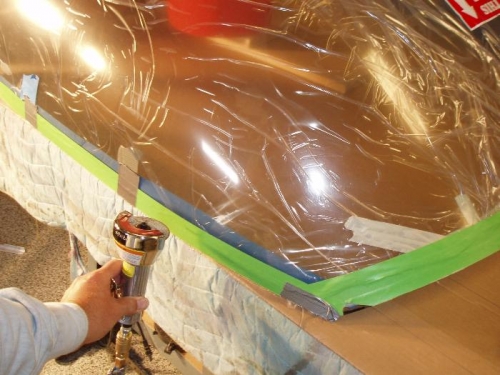

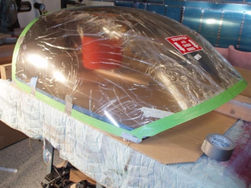

I put tape on the cut line and taped down the protective film out of the way.

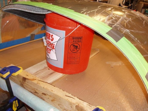

I put the canopy on my table saw and supported it with a 5 gallon bucket. This allowed the side of the canopy to hang over the edge so no pressure was on it.
I made the cut like before and smoothed the edges.
