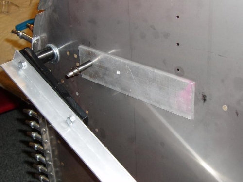

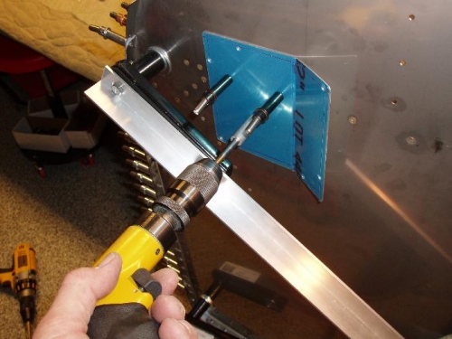

Then after I used the tool to drill the two bolt holes I realized I needed a bigger tool to locate the 1/2 hole for the nipple. So I made another tool.
I used bushings to locate the center of the 1/2 hole and drilled it. Then a step drill brought it up to 1/2 inch.

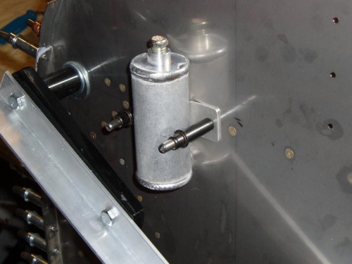

The resevoir is located.
I think I'll prime and paint this with engine paint.
Used tool to drill bolt holes
New tool to drill 1/2 nipple hole
Resevoir located
Resevoir located
