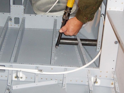

Install Step 4: Drill Plastic Block holes and Prim
I drilled the holes thru the rib and step using the plastic block as a guide.

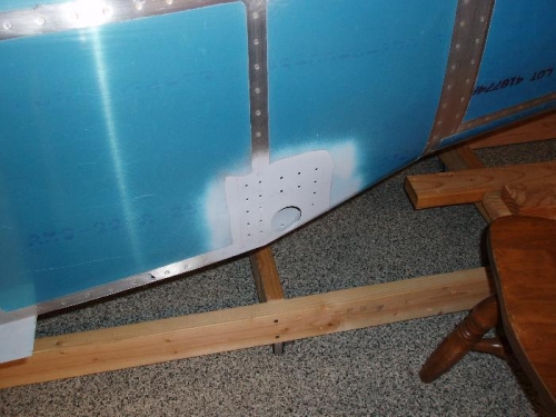

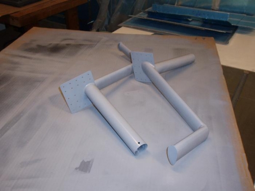

I sanded the steps a lot to get the black stuff and letters off. Then I washed and primed. I put a little primer on the side skin also.
They are ready for final riveting.
Drilled rib and step thru block
Primed side a little
Sanded, Cleaned and Primed steps
