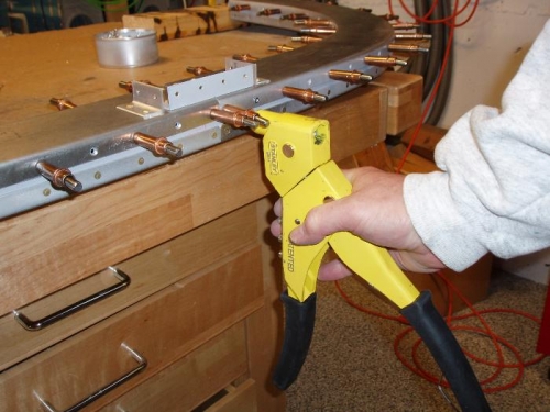

Finally it is time to finish riveting the two halves of the frame together. This is done using flush head pulled rivets. At this time I also added a little more countersink on some of the holes to make sure the rivets were flush.

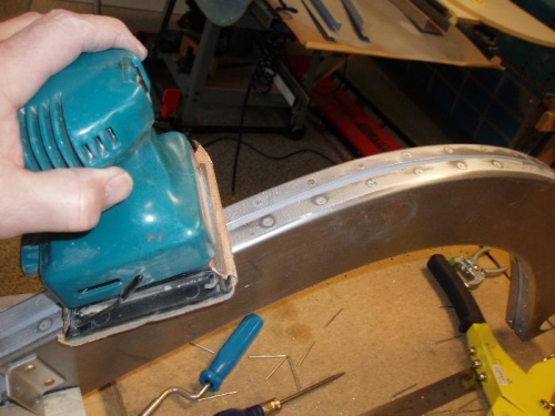

After getting it together, I decided to make it smooth. Some of the rivets stuck up slightly or were tilted so I used a file and then my sander to smooth everything off. This frame will be painted and show thru the canopy so I want it to look good.
I'm contemplating filling in the pop rivets holes to make them look flush.
Pulled rivets to finish frame

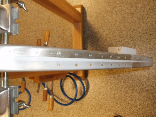

All rivets smooth and good
Sanded rivet heads to be real smooth
