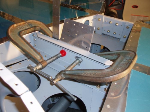

Next per plan is to mount the vertical stabalizer. First you clamp and drill a bracket to the forward spar of the horizontal stabilizer (HS). I drilled one hole per drawing to help locate it. Then clamped and drilled the other three.

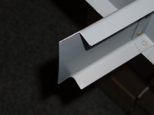

Then I trimmed off the flange of the forward fin spar. Should have trimmed off the web as well, but I end up doing it later.

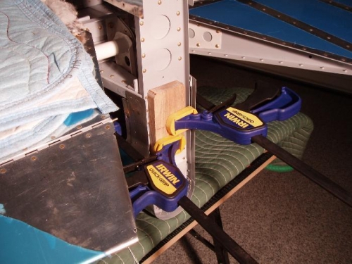

Then I clamped the fin on the fuselage. Drawings has a measurement called out for vertical position of the fin. It 7 11/32 from top of longeron to top of hinge bracket. So I measured carefully and clampled the fin in place. I also checked to keep it centered.
Clamped and drilled the bracket
Trimmed off bottom of fwd fin spar
Clamped fin in place
