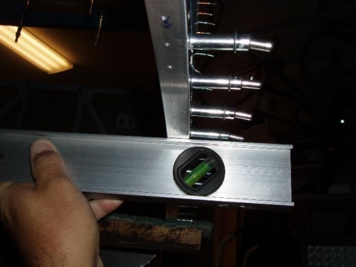

2) Measure if longerons are flat at the elbows. I put a level across the longerons in between the 705 and 704 bulkheads about where your elbows go. They look flat. I could imagine a slight twist in the left one, but it appears flat enough, I think.

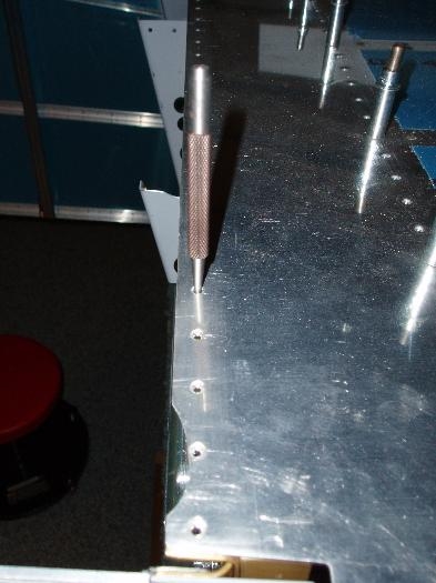

3) I checked to see if my mid-fuselage bottom skin holes were still lined up with the 704 Wing Bulkhead. And yes they are as shown by the vertical punch slid into one of the holes.

Longerons flat at the elbows
Holes are lined up
Holes are lined up
