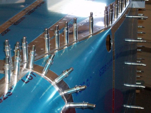

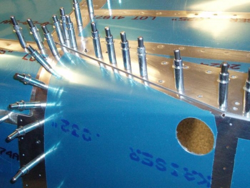

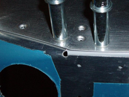

I put the skin back on, starting at the aft end. I removed clecoes on bottom skin so I could push bent tab under it. It fit fine. No issues. I must have got lucky. No cracks either.
The holes are not dimpled yet so the bottom skin rides up a little (see center photo) but this should fit great once all the holes are dimpled to match.
Looks smooth and good
No cracks on hole
No cracks on hole
