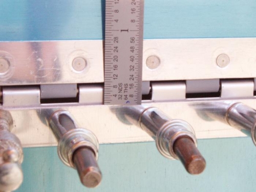

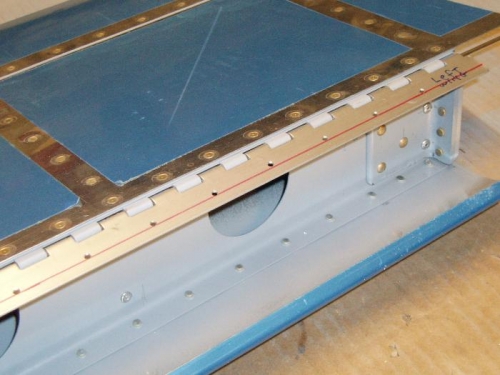

Result was great. Plenty of edge margin. The red line shows 1/4 inch from edge and all the holes are above it.

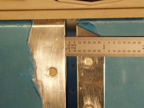

LESSON LEARNED, when you drill the hinge to flap make edge margin less then 1/4 inch and you should be able to meet edge margin when you drill hinge to wing. Unfortunately I put the flap part of the hinge on with full 1/4 margin and that didn't allow enough space to attach to wing.
About 5/16 gap
About 5/16 gap
You can see upper hinge to far on
Greater than 1/4 edge margin
