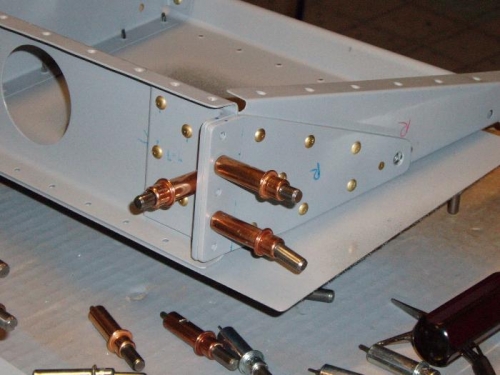

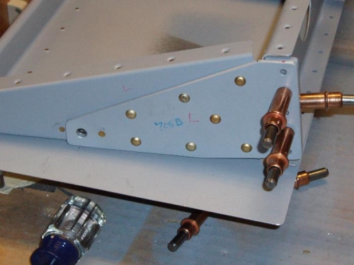

Brief Description:  Flaps - Rivet doubler to rib
Then I positioned and clecoed the rib and doubler in place with the spar and skin and made sure everything was in alignment. Then I riveted the doubler to the rib. I did not rivet rib to spar nor skin. I started with the doubler and rib clecoed in place but after a few rivets I removed it to finish all the other rivets. I used the squeezer.
Inboard rib and doubler riveted

Rib is NOT riveted to frame

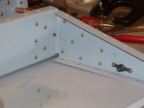

Shop heads of doublers to spar and rib
